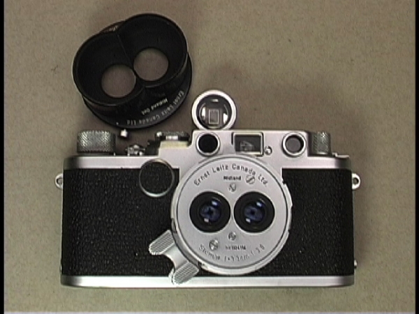

눈이 둘달린 카메라인데 찾아봐도 정보가 없네요...
어떤 카메라인지 정말 궁금합니다... ^^

희한하게 생긴 카메라네요... 저런거 처음봅니다 ㅡㅡ;;

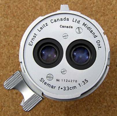

Stenar 33mm Stereo
Produced by Leitz Canada between 1954 and 1957.
A pair of lenses with the maximum aperture of f/3.5 focal length 33mm.
Lenses designed for optimum stereo effect at distances less than ten feet.
For longer distance a prism attachment was used.
Catalogued as bayonet only, adopted to screw by removal of bayonet flange.
During the war Wetzlar produced a 35mm f/2.5 Stemar as an alternative to the Elmar 35mm Stereo.
http://www.kbcamera.com/rarityratingslenses.htm
여기에는 무척 귀한 렌즈라고 나와있네요!
http://kohscamera.com/Leica-Used.htm
Leica Stemar 33mm F3.5 Lens w/ Cap, Hood, Finder, Prism, Case Exc++
렌즈만 $6,450이라네요!
